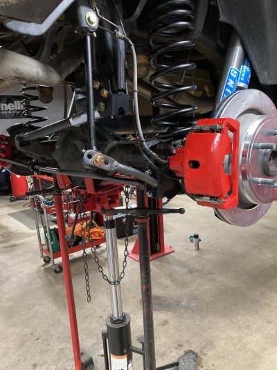

I can’t speak to the super lift coils, but I have no complaints with the Icons +1.5” coils I’ve had for 2-3 years now.
