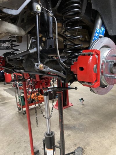

I have the Icon 1.5” lift springs, been happy with ride & haven’t had any noticeable settling, but only haul the occasional piece of furniture my wife finds/wants & don’t tow.
I have seen mixed reviews on them here but believe most of the negative ones are from members who use their trucks haul or tow frequently.
Mine have been installed about 4 years.
