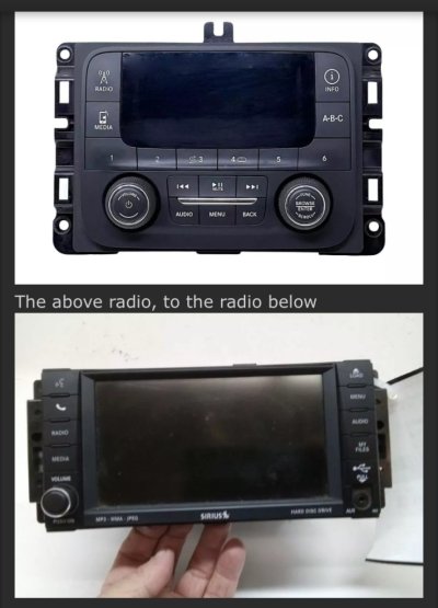

IMG_0880.jpegOne of these two? The top one is what I have now. The bottom one is what I’d LIKE to put in.

Send me a message for the 8.4 upgrade or via website... But that bottom radio is a definite no-go

Pretty sure that radio will support a backup camera - read theough and pay attention post # 11 in this thread
The camera will need to be activated, I'd recommend getting AlfaOBD and doing it yourself instead of going to a dealer. More info that you'll ever want to know about it can be found here

Are you talking about the RA2 camera will work with a back up camera? Does it have to be an OEM camera or will an aftermarket camera work (hopefully since that’s what I have). Is there a particular PN for the radio I need to look for?
I’m getting soooo confused by all the acronyms and everything I’m reading.
And full disclosure, this is actually my wife’s truck. Just getting a factory radio in it and working was a brownie point, but I’ll earn 10x that if I can get her a backup camera working.

Yes - the RA2 will support the backup camera, and the radio that @diymirage has for sale is a good price. An aftermarket will work, read through the thread I posted above, it tells you how it was hooked up.
