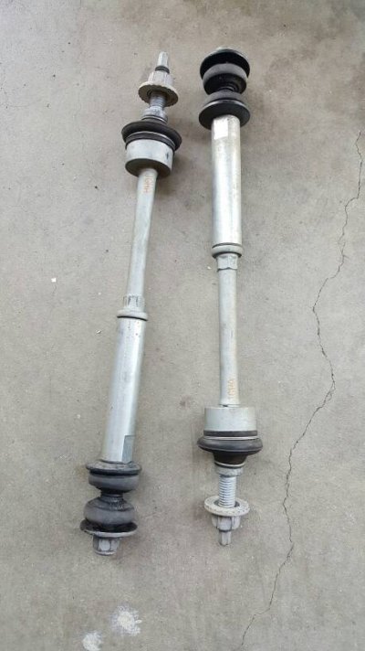

Im going to..
Will get some good pictures and measurements today, then start on a solution.

So I've done no investigation here but would a quick disconnect kit work from a JK? I don't know the pin diameter off hand but you can just mount the extra brackets wherever is easiest to hold the links up and out of the way. I had the metal cloak version on my JK and they worked great. Just tap them on and off with a rubber mallet.
Synergy Jeep JK Front Sway Bar Quick Disconnect Pins and Mounting Brackets
Longer links might allow the bar to sit closer to its stock orientation but I would b a little concerned about making your shock the travel limiting factor in your front suspension.

As far as the quick disconnect..you would pretty much have to have a pin on top and bottom.. Most of the other products are designed for a 90° top or bottom application.. So you disconnect, then swing it up and lock it. These cannot be "swung up" because its on a balljoint and not a swivel. (This is my understanding after examining it.)
As far as all the support being on the shock, I'd like to hear some more comments on that. Because if it is, then that doesn't seem good... But what about all the other vehicles that disconnect for offroading? What is supporting theirs? Or is that an ifs only thing?
