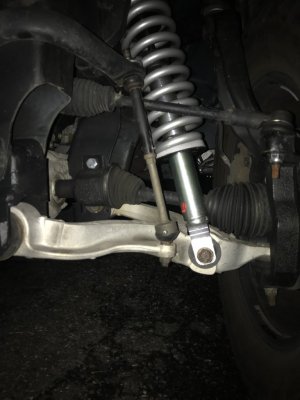

i got 1 destroyed sway bar end link....im going to purchase 2 and just replace them both...but the truck has a 6" zone suspension kit leveled. its a 2015 ram sport 1500 4x4 crew 8 speed....i guess whats on there now is a mopar factory link with a zone spacer on top of it....but i just cant seem to find anything...and or i don't want to order a wrong one. thanks guys.

you might check Zone or BSD for longer links.

I looked for ever to find them and couldn’t. I went through suspension maxx. I had to measure center to center on mounting bolts and they custom made me a set. A bit pricey I think $150 for the pair but only ones I could find

9C3742B5-80CE-481D-AC37-85AEEE7109D3.jpeg Zone and BDS both use swaybar endlink extensions so all you need are the standard end links for your truck. And you’ll reuse the extension. I went with moog ones they’re greasable.

View attachment 145096 Zone and BDS both use swaybar endlink extensions so all you need are the standard end links for your truck. And you’ll reuse the extension. I went with moog ones they’re greasable.
yeah i have the extensions up top. so just remove the bottom portion? moog has a set they said.
Quick_Shifter
IG: @ak_trucks_pa
TOTY Winner
Aug 14, 2018
4,342
4,346
ASTON,PA
AK Trucks Tuned 5.7
Yes Sir, doesn’t have to be moog but they are good ones.

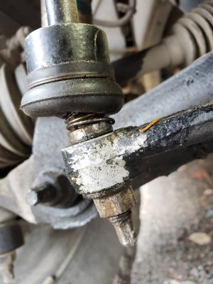

the only problem i have is the bottom nipple part with the nut above is stripped....i cant get the fkin thing off...or anything to hold onto that bottom nipple.
ram1500rsm
Jul 24, 2018
4,891
5,413
Trabuco Canyon, CA
Have you tried channel locks, vice grips ?, if that doesn't work, you can try to weld a nut, or take it any local mechanic shop and offer them $20 to get it off.
Quick_Shifter
IG: @ak_trucks_pa
TOTY Winner
Aug 14, 2018
4,342
4,346
ASTON,PA
AK Trucks Tuned 5.7
Mine was the same way I used a mini pipe wrench
