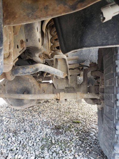

My truck is a 97 1500 with a 2-3" lift in the front. I took the sway bar out of it years ago while I was offroading alot and put it back in probably a year ago. I've gone through 2-3 sets of swaybar links since they just get destroyed by the angle they are running at. Now I'd wager I just need to add some longer swaybar links in but before I go dropping that money since I also plan on dropping the cash on the 98-99HD T style steering hardware to get away from this loose Y style it came with. I'd appreciate some input if I'm on the right track with this.
Heres a picture for reference

You can also get swaybar drop brackets from HellBentSteel.
Longer end links are better but depending on how you're using the truck nowadays the brackets are an option at least
