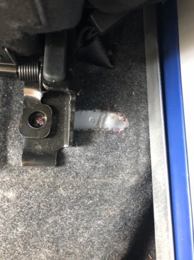

So I finally got most of my other projects done and went back at this today while I was installing new to me front seats and some sound damping material.
Managed to punch right through and there were indeed threaded holes. 5c88395a760fd3f091b589ebe96f87ad.jpg
Pic should show no hole on Saturday de that would have the drivers side portion of the rear seat. It was in fact a painted over piece of butyl tape.
