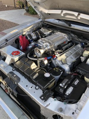

Your right!!!!! I love the whine from my supercharger
Looks like the engine compartment of a 2003 and up Mustang. Buddy bought a new one back in 2003 (390 horse supercharged 4.6 Cobra) and I got to ride in it a couple times and damn it was fast. I couldn't imagine that same ride in a Hellcat or Demon hell I would probably get so excited I would have a heart attack.
Close enough 1999-2004 mustang compartment actually. Mine is a 99 with slight mods hahahahaha
