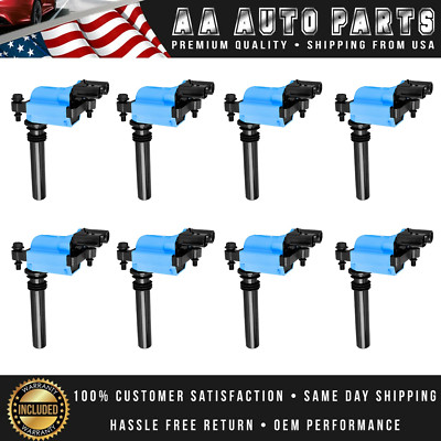

I put these coils on my old 2004 Ram 1500 5.7. Like you I needed something quick and cheap, since I had 2 coils go bad. Put them in around April of 2021 and had no problems with them. Ran them for over 2 years, until I wrecked the truck.
As far as plugs, I used Autolite AP5263 and have never had problems running Autolites, in any vehicle, in over 30 years of using them. Plugs for the Hemis are expensive, since you need 16 of them, but, you can find some decent deals if you look.
