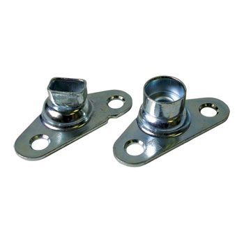

JIMS auto parts may have the parts
the are in Salem New Hampshire
looks like it may be called the Tailgate Pivot
ask Benny if they are still a stock item
Dorman part
i wonder if these old hinges work on a 2015 ?
with this old style, the one on the right, the ROUND ones goes on the drivers side
