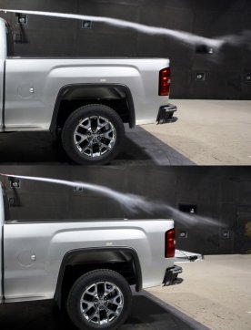

Gondul
Oct 25, 2018
107
74
Central Florida
While it is unfortunate the design happens to interfere with your use of the vehicle, it is by no means a poor design and quite intentional with a very specific purpose.
Open bed drag is a long standing myth, the lip on the tailgate helps to smooth the airflow over the back of the vehicle reducing drag.
The Chevy below shows how the tailgate up has a much smoother airflow than tailgate down.
On the RAM here you can see how much smoother the airflow is over the tailgate rather than the Chevy because of the lip.
I have no idea why this image keeps showing up even after I delete it...
