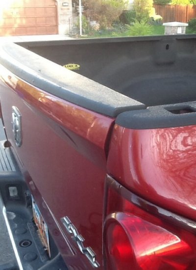

Will it physically fit & work? Yes. Will it look funny because nothing will line up body line wise? Also yes lol.
image.jpgScreenshot 2023-07-12 at 15-41-01 4th gen tailgate on a 3rd gen truck.png

Any 2002 ½ ton (not 2002 HD) to 2009 ¾-1 ton (but not ½ ton) tailgate will work.
