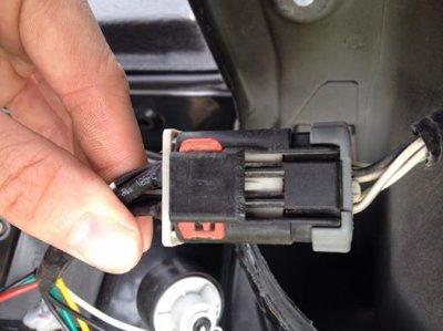

Passenger taillight has not been working. This connector seems to be the issue. The connections inside are corroded. SO no power is getting through... Figure I would just replace this whole connecter, but cant find the part number for it. Not sure whats its called.... Can anyone help me out?

If Your Sure That's The Issue If It Was Me I Would Just Cut The Connector Out And Butt Splice The Wires Back Together

If it's not too bad you could try cleaning it out with brake cleaner first. Spray some inside then dry it out with compressed air and maybe you don't have to sacrifice the connector.

I will give the brake cleaner a try, thanks for the tip!

My Guess Is its that board on back of taillight though iv seen a bunch of post with them going bad

Ive tried two sets of tail lights. Stock and my after market ones. My Blinker will work on both. But on the stock ones the top light is getting power but not the middle one. and on the after market one it wont light up at all but the blinker works... Im not getting a lamp out light though. So im guessing it has to be this connection point. darn electronics! lol

Yeah It may be the connector then

Get corrosion cleaner for battery terminals and dielectric grease
Clean it out real well and coat it with dielectric grease to prevent it from happening again

Last 8 of your vin and I'll run it through my dealerships parts I'll get u a part number

If it's the right part number the it's 05013984AA
