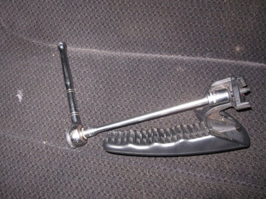

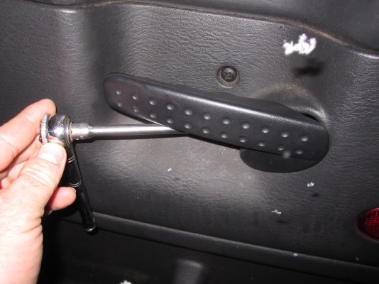

On my 08 you have to pull the handle like youre opening the door, and then either stick a socket with an extension or a torx screw driver back there to get the handle off. With a light you should be able to easily see the screw you're looking for.
Use a 10mm socket on a 6" extension to remove the handle.

You just have to pull the handle like you're opening the door and put it at an angle following the handle and it'll fit with plenty if room.
