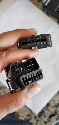

My biggest question is will the Tazer work with the AEV security bypass? i bought the AEV bypass kit for cheap, and would prefer not to have to rip my radio out

I realize I am late to the game. One thing I noted for the RAM 2018 on the Tazer is that the security bypass must be removed when taken into the dealer or their tools will not work. I hate to have to take out the radio each time my truck went to the dealer. I have the Maxcare lifetime service agreement. Is there a way around this?

Yes. Remove radio then there are 3 screws holding the little security box. Unplug box and keep it somewhere and plug the bypass in. Install everything back and you’re finished.
Do you happen to have a photo? I removed the radio and the security device, but the two plugs do not plug anywhere in the bypass, I am not sure what am i missing here. Can you please assist me with this? see pictures of the bypass module, where should I plug those 5 plugs?
Thank you
