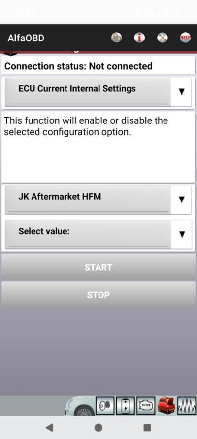

Its possible the pairing is done on the radio side. Maybe this setting?
Definitely possible.
I found a "reset vin values" option for our 2013+ powernet trucks too.
JScan also has the ability to connect to those modules, but won't show the sub-menus unless connected.

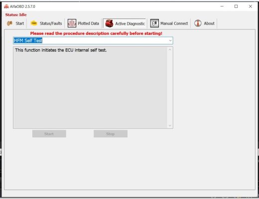

How about this test to evaluate the existing HFM?
