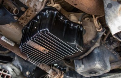

This is for visual reference only. These pans are expenive but you'll get the idea. Little silver spot in the middle of the pan.

FFBCFA06-D153-4DD6-B607-FB516EA09E2C.jpeg I had a MP pan, it had a boss on the passenger side. I had mine in there just out of laziness that I didn’t want to cut the cooler line.

That's annoying. I have a LPW pan on my 12v right now that I drilled and taped a hole on the back side like the Mag-hytec. Peace of mind for protection.
