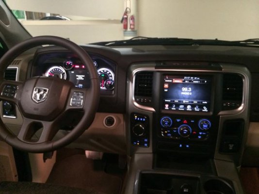

As for the auto setting, I'm not sure about it. This is a picture of my stock interior.

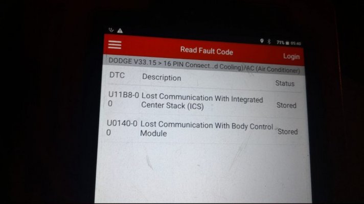

OK.. There is an update.. This is the fault code.
According to the mechanic the airconditioning system is not able to talk to the head unit / AC system and therefore the system is working overtime when in reality, the compressor needs to be able to cut off periodically and its not.
This is what I can understand.. So if anyone has experience with this and one of these headunits, do let me know.

This is what it looked like stock.

I believe it is single zone.
Your pic is a little blurry to make out details.
If you have an "Auto" button on the HVAC screen and possibly in the center of the fan speed knob then you have the ATC mod.
If you're center bezel has two sets of warmer/cooler buttons and your HVAC bezel looks similar to this:
That's the factory dual zone, there will also be two temperature slider on the HVAC page along with temperature settings (at the top of the screen).
