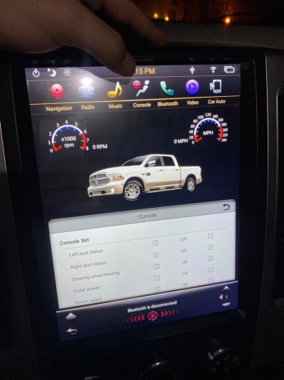

So I’ve had the Phoenix Automotive 12.1” Tesla Style Radio for about 8 months now and I just installed some Kicker CS2 speakers and I can’t get any bass in them at all. I tried both the audio equalizer and I tried the other settings that are under the “Console” menu option. No bass and actually it’s not changing the treble or anything. The only setting that changes anything is in the equalizer presets where I can select Rock, Vocal, Classical, etc.
What am I doing wrong here? Can someone help me with the settings, I tried changing a bunch of them and it didn’t matter what Hz k changed the settings too, it did nothing.
Picture for radio reference
