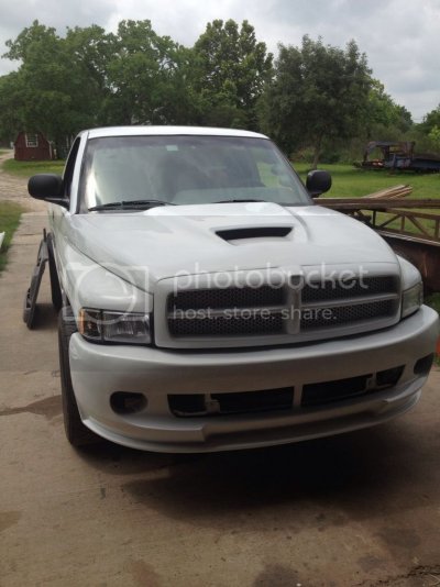

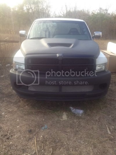

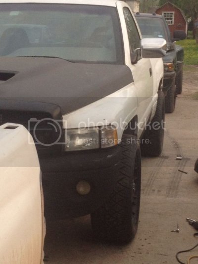

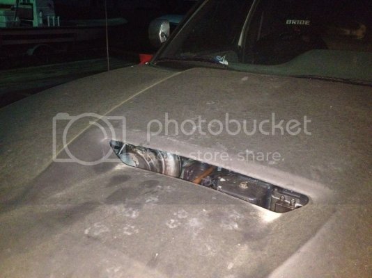

Awesome thanks ill look them up. I wanted a shaker hood but after my Hemi swap it won't fit. This is the only other hood I've seen and really liked on the 2nd gens.
It's probably cheaper anyways lol. How was the fitment of it? Need a lot of work to fit proper? This will be my first aftermarket hood if I get one.
The fit was ok, you will need to make the mounting point for the hinges and the hood latch. Which isn't hard For the grill use jb weld on the screws that Mine tore out of the fiberglass after awhile and you may need to do some sanding on the front lip. Overall not terrible for a good looking hood that will give you a small weight loss. It is the only second gen hood I have found that I can stand.
