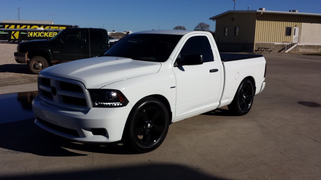

JJ's TYC builds......great lights.
I had stock duals and went stock TYC, much better. Didn't add the coin to get them built tho.

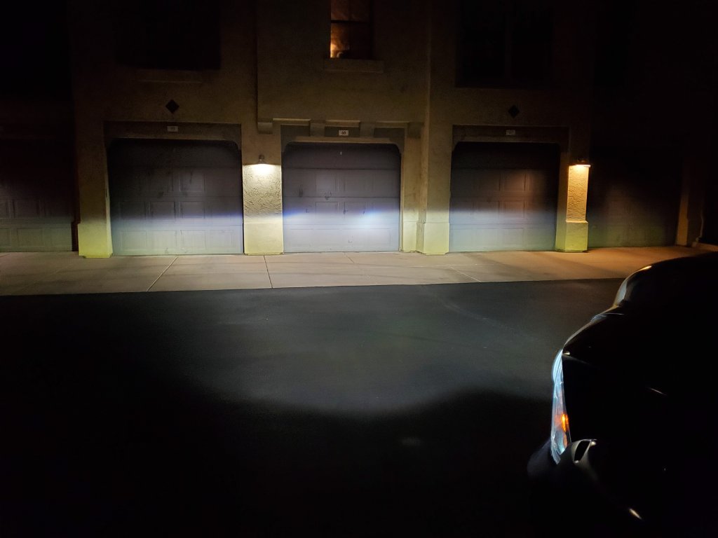

I missed the original convo about your experience with this. Could you link me or brief me on why your G1 were horrible with HID bulbs? I have HID's in my factory projectors which I'm well aware are not the same projector. Did they use an H1 or H7 style projector vs the 15 9012 bulb I used? I'm wondering if maybe just effort would bring those bad boys to life if at all possible.
Again I've never had my hands on any of the aftermarket lights. I specifically got my truck with factory projector headlights with the idea I would have HID's. After my purchase and ignorance I realized work still needs to be done.
With enough research I used the proper equipment to get my HID up and running. They surpassed every expectation I had. The only reason I would get aftermarket is for the 2019 look or because I'm reluctant to fight with permaseal.
I realize headlights are a major deal with these trucks. Thinking out loud one would need to have a couple truck variations that they own to physically and schematically to see the differences between them. Then engineer the non led truck to led simplified.

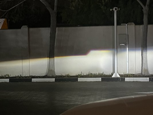

Any adjustments that can be done to get this step out of my view as I recently installed a TYC projector headlight and LED bulb. It’s very annoying

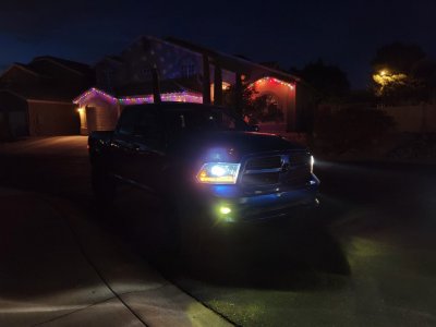

A little late and Inexperienced, I chose the Alpharex LED Projector Headlights !
I didn't know where to go but these worked out well.
Plenty of light, great DRLs, and look great.
I went with a black background but clear lenses.
O also got the Alpharex LED Taillights... something different, other than OEM LEDs.
