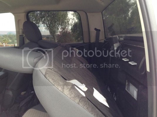

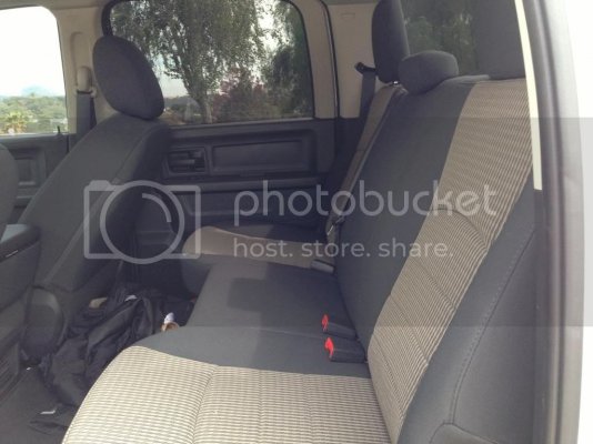

I've found a solution that at least worked for me, put a nut and one washer under the rear seat at all 4 bolt locations and now it works like a charm. The height added came out to 3/4" and still plenty comfortable to sit in the backseat, unless you're often hauling your basketball team back there :badidea:.
After spacers and everything still locks and looks fine.

I didn't really want to raise mine, so I followed the write-up I saw here or somewhere else. I simply cut off 5/8" from the metal hooks on back of the seats. In the end, the result is the same, the seat remains at stock height. I'm so glad I did this. I'm installing amp now, and it would be a major pain w/o being able to lay the seat down.

now yall get those headrests cut down a little so you can see out of the back window!!!!! Outstanding mod

That wouldn't work on my split folding rear bench. I had to cut the hooks, and put a 3/4 in spacer in. :(

^ Mine is split. I cut off my hooks directly below the plastic piece. Both sides now fold down.

How far down will the seat lay ?
Till the head rests hit, If you take them off I bet all the way.
It offers enough storage to at least mount an amp on the back wall, so you could probably fit a long skinny tool box back there(road hazard triangles, bungee cords ect)

I pulled my headrest off so I can see. I was just wondering if it would lay flat enough to lay things on

I just did this on my '13 CC this weekend. Remove the four bolts holding the seat down then add about 5/8" of spacers (washers, nuts, etc) between the seat base and the floor. Bolt it all down and you're done.
