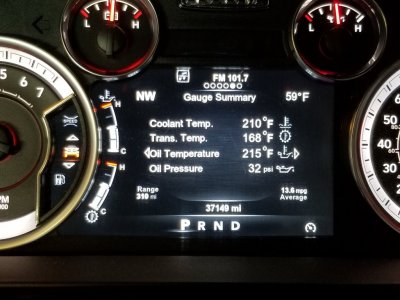

i stumbled across this thermal bypass valve for the transmission for our HD trucks. I’ve read it keeps the tranny fluid cooler, making the tranny last longer. Is it true? Is this worth it? Any cons to this? I do tow 7k lbs a few times a month and never seen my temps above 172. If adding this will take preventive measures, Why not right? $100 to extended the transmission’s life, cheap insurance.
