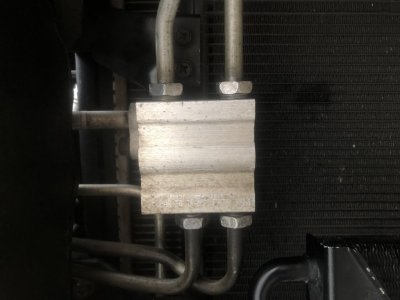

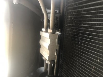

Okay, I ordered the ATS TVB and went to install it and it does NOT fit on a 2013 Ram 2500 5.7 hemi w/66rfe. The male threads on the cooler lines are smaller in diameter than the female threads on the TVB. Back to square one. I emailed the guy from the manufacturer who told me that the TVB would fit my vehicle to let him know that it doesn't. Hoping I'm not out $110 and that they will let me return it as there is nothing on their website about returns.
Apparently, their distributors know more about the manufacturer's product than the manufacturer knows because I was told it wouldn't fit my truck by one of their distributors.

Can you post some pics of your TBV on the truck please, and some of the one you got?
2018 Ram 2500 6.4L 4x4
Amsoil SS 0W-40
Everything lines up, but the threads don’t match.
The cooler lines on the truck don’t have any clips, they just thread into the block.

Too big or small or wrong thread pitch?
Anyway you could find a brass reducer to make it work? Or at this point find a brass union to just hook the lines together and return the ATS block

That's what I was wondering....if I could just rig something up between the lines.....same as the block. I'm gonna see what I can do.....put the old crap back in for now. ATS got back to me already...said they'll start to set up a return and refund on monday.

The fittings on the truck are too small for the ATS....I'm gonna try and rig something between the lines. Thanks for trying to help me out, I appreciate it.
