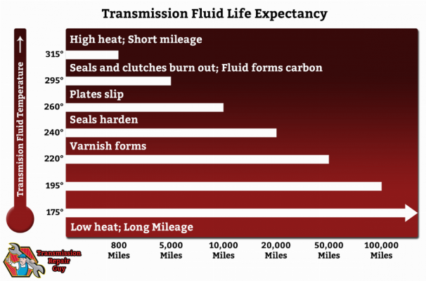

Which temp do you want your personal transmision to oprate at? Um, Ill take the last line thank you. Below 175f, I have towed and traveled and I have never came close to 175f, I am glad I didn't have to replace that vavle because my truck never had one.
