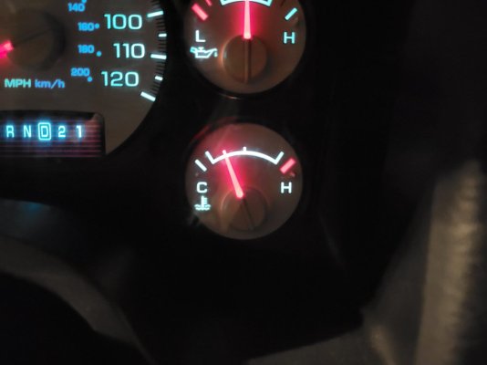

Great. So i replaced the thermostat with a 195 one today. Top radiator hose coming out of thermostat is 130 running or 150 after i turn the truck off and let it sit for a few min in my garage. the needle on the gauge is in basically the same spot as before i replaced the thermostat.
I havent got a check engine light yet but only drove it maybe 10 or 15 miles or so. All of the readings are on my infrared thermometer in 28 or so degree weather.
It looks like i might have replaced the thermostat for no reason just like i did for my 08 4.7 ram. Probably the coolant temperature sensor is bad in this 5.7 just like i am suspecting the same on my 4.7.
This is exactly why i asked how do you tell whether the thermostat is bad or the coolant temperature sensor. Frustrating that i replaced both thermostats this weekend when more than likely the coolant temperature sensors are bad on both and the thermostats were fine
Im not upset at anyone on the forum and am greatful for the help on my thread. On the positive side I guess now i know the thermostats are good on both1000015119.jpg

Take a infrared heat gun and measure the temp on the return hose and top of the block. T stat stuck open the motor and hose will be below the proper temp.
You were given good advice on how to check WITHOUT replacing the T-stat. You say you drove it 10 to 15 miles and the upper hose is still only 130 degrees, 150 after sitting. By the way, the upper hose is hot water returning to the T-Stat and the radiator. Thus, that hose should get to 195 before the T-stat opens.
The temperatures you are getting are too low with a 195 T-stat if the engine is completely warmed up. Take it for a much longer drive and measure the hose temp. On my 2021 I can see the temp go up to 103 Centigrade, it then drops back to 96C when the T-stat opens, shows right on my dash. Just so you know, 100 C is the boiling point of water, so it is the same as 212 F, at sea level and normal atmospheric pressure. You cooling system is at 14 or so PSI so boiling point is higher and that boiling point is further raised due to the antifreeze mixed in with the water. As far as the sensors being bad, your gauge looks like it is reading pretty normal to me for the temperatures you are getting with the temp gun. I do not see any evidence of too high or too low a temp for what you measured and what the gauge on your dash is showing. The heat gauge should be in the middle or close when that upper hose is at 195 degrees.
You are the one choosing to fire the parts cannon without doing the proper diagnostics or really understanding how your cooling system works, or how your gauges should read at various engine temperatures, so if you want to be frustrated and pissed off, you only have yourself to blame.
