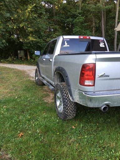

Back in my Jeep YJ days, it was very common to see 12.5” wide tires mounted on 8” wide rims.
I currently have 35” tall by 12.5” wide tires on my stock 20”x9” rims.

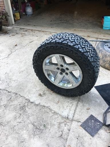

I have 35x12.50r20’s on stock 20x9 sport rims with Bilstein 2.8” level. I believe the width would be the problem on stock 20x8 rims. You could run spacers.
I ran a 34” tall, 11” wide without the level on my 20x9 sport rims without issue.
Those look really Good, I was going to run 1.75" wheel spacers with a leveling kit
