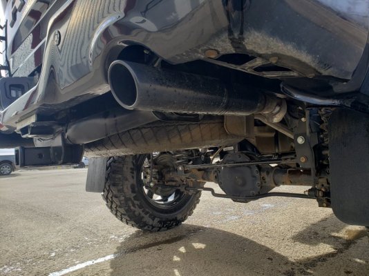

I had a 3 inch body lift done to my 2017 Ram and it looks great! When I still had the stock front bumper on I believe it just mounted to a bracket included with the kit. My new low profile bumper needed some tweaking by the shop but ultimately is where it should be now. My tailpipes definitely need to be raised up as they are now 3 inches too low. I have a Performance Accessories lift kit and Bilstein 5100's at 2.8 up front with a one inch spacer in back. Personally, I am glad I had it done but it can make aftermarket parts fitment problematic.

I have a 6" suspension and 3" body lift, had the exhaust redone and running 37x13.50x20 on 20x12 rims, for me its the perfect height and wheel stance for a lifted truck. These trucks run the body lift very well, no gaps anywhere on the truck and its really hard to tell if it has a body lift unless you walk lol under it hahaha, you won't be sorry, all the best.

i did the zone 6 inch with 5 in springs in the back, 2.8 bils in front and back, some 1.5 body lift pucks, looks perfect imo after adding 5 in exhaust tips. the body lift is super simple to install if you have an angle grinder and hammer drill. The 3 inch lift i think would show too much underneath and look off.
running it with 37 13.50 20
with the 91 can tune, sb cai, flowmaster outlaw, and throttle response adjuster it's surprisingly ballsy
