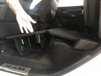

Image.jpeg Well my JL box is in the truck with 2 10TW1. Load floor doesn't look like it's going to lay anywhere close to flat. It can stay in, but not really use able. Working on a solution, but if I can't find one it's going back and I'll go custom fibreglass and a pair of sundown SD3 8" subs instead as I've measured and I can make them and the floor fit with a small seat lift. I'm thinking I'll do a small seat lift and add a small spacer to lift the load floor as well to see if the JL box will work before I get too far ahead of myself. Any ideas?

I wasn’t thinking that load floor was gonna work with that Stealthbox under it which, after my trip to Louisiana, that damn fold out floor was actually kinda nice cuz it gave more room to put **** in the back; plus it kinda helped protect the leather seats by having them folded up...Lol.
Oh well, whenever my replacement Stealthbox box shows up- had to return the first one because the right side speaker grille was all mashed in from the factory, I still don’t think it’s gonna be too terribly heartbreaking to pull the floor out since I got by with it being removed in the old truck.

with the seat in the original position the fold flat floor when flat was 4.5" off the floor. With the seat lifted 3/4" that gap fell to 1.5". Add the floor mat and it's 1". If I can find a way to lift the load floor 1/4" without binding when the seat folds up I think I can get the front leg on the floor and the middle leg should be close. Bit more of a hassle than I wanted, but I think it'll work in the end.

I'm happy with the sound and it's plenty loud. Still a bit to do to get it tuned and I haven't run it through its paces with the floor down. Seat is just sitting on 3/4 mdf for mock up and not bolted in at the moment. Need to get some 2X3/4 aluminum flat bar to make the spacers and get longer metric bolts. Then I have to play with the load floor and see if I can get it working. It better sound really good given the cost and effort at this point. I feel hustled by JL audio with the you can retain the factory load floor. I may still remove it if I stay pissed off and go with something else, but I'm doing my best to make it work as I need the floor. It's my bed on long work trips so taking it out will prove either very uncomfortable as I try to sleep in the drivers seat or expensive as I'll need more hotel rooms so removal isn't really an option for me.

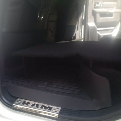

IMG_20180503_153625.jpg IMG_20180503_153857.jpg I've started making adjustments to get the load floor in. Put in a 1/4" X 1" piece of aluminum flat bar between the seat and load floor and I have the floor up 3/4", but my aluminum still hasn't come in so it's temporary. Floor is 1/2" off the floor when perfectly flat on the front legs. Rear are about 1", which makes sense since that's how much the box sits above where the floor used to rest. With this setup the floor is totally useable. Picture is with the front floor leg on the floor mat.
