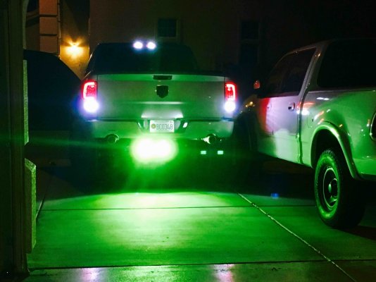

I tapped into the reverse light wires as well. I have these pointed out about 25 feet to the ground and that works real well.
I live out in the country and there are no lights close so its pitch black and these light it up great.

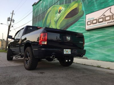

I have mine on a separate switch in the cab. I ran the wire along the ebrake cable.

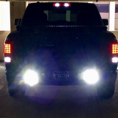

I did the flush mounted ones. Very clean....
I tapped into the trailer wiring harness. The center wire is for reverse.
