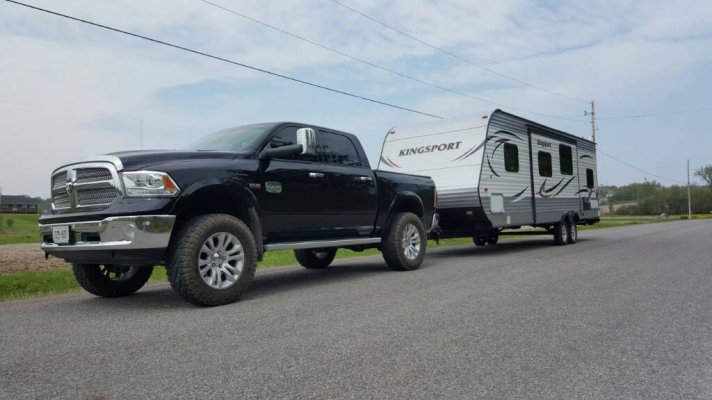

I'd skip them and go to the airlift 5000 bags. If I could do it over I would have waited to get the 5000 bags when they came out this winter.
This is with 40 psi (5lbs over max) in the bags and 900 lbs on the hitch.

Are you using the 1000's or 5000's in this pic? Looks like little to no squat all (the angle makes it kind of hard to tell).
I haven't leveled the front of the truck, so I assume with a bit of weight on the back I would still be "level" if I were using the 1000's?
Sorry I'm using the 1000 airbags. There is 3" of squat with the trailer on. With 400 lbs on the hitch it sits perfectly level with the airbags at max. That is 1" of squat
