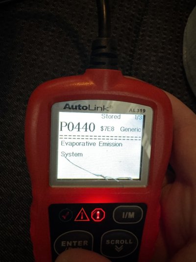

So just recently over the past few weeks I have had three codes come up. P04440 - P0456 and last night P0463.
I’m not too worried about them because the truck still runs and drives fine and based off what I have read it won’t do any long term damage. I clear the codes and it’ll go probably 5-7 days or even longer before one might pop back up.
Since they’re all sort of related to the same thing could it be something as simple as a sensor like the p0463 causing these to come up? Has anyone ever had this happen before? If so, what was a fix that you did?
