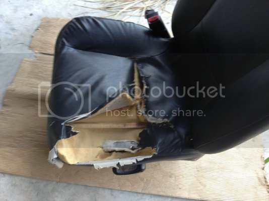

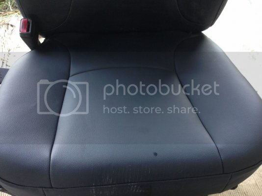

Now, the process. I pulled the seats. The passenger seat is fine, but it's getting the enhancements. This is what I'm starting with.

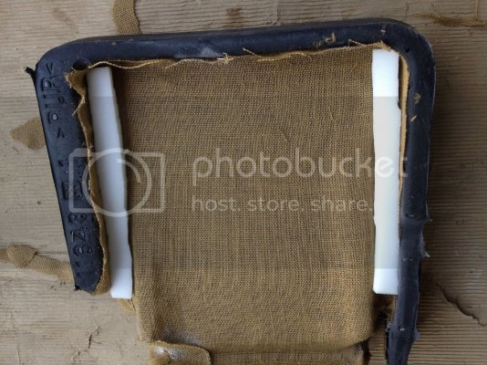

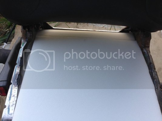

Now, unclip/remove the old bottom cover and foam. Take one of the carpet mats and cut to fit inside the frame over the banjo wires. I let the carpet overlap the bottom front of the frame, but it's not necessary. Supposedly, this will keep the wires from cutting the foam over time. Note any rough edges and file/hammer to protect the foam. Then take one of the foam sheets and cut to fit the inside bottom frame. Use another piece of foam and cut a filler strip, as seen in the next picture.

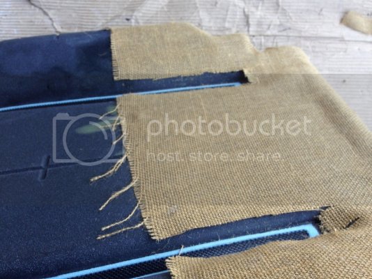

Now, use the spray glue and burlap to cover the factory cushion underside. It's making contact with the frame and that's what another tutorial advised. I took the precaution to wrap the tapered ends and the back half of the seat, as that's where your weight is borne. Wrap the whole cushion, if desired. Just keep the velcro strips open. Frankly, I don't think the burlap is necessary as I saw no abrasion damage. For that matter, I saw no evidence of the banjo wires cutting the foam. The carpet is still worthwhile, I think.
Entire cushioning back in frame. The reason I said to remove the hinge bolts is because the extra thickness makes it difficult to place. You can lift the back to get clearance, but wait until the new cover is on before re-fastening those frame hinge bolts.
Now, cut two strips of foam ~1" wide. These will go in the cushion underside channels where the cushion would normally contact the frame. But because you're adding (in this case) an extra 1" of foam, you need these filler strips to maintain the same relative exposure of the frame to factory cushion. The other tutorial I read didn't call for it, but I realized if you don't, the bolsters will get flattened out because of only the center having the extra support. I think that man made up for it by overlaying the top with foam. That looks like **** and loses definition in the contour, IMO.

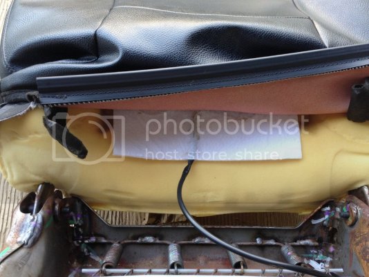

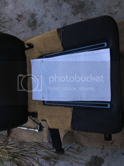

Bottom heater pad is affixed. Basically the same as the back; trim to the edges of the heating elements, and it's perfect. The wires were indexed on respective sides to the inside; that is, run them towards the console side when routing them under the upholstery.

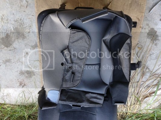

New cover. Start with it inverted and if possible, let it get warm as it'll aid in fitting, especially when overstuffed. I affixed the velcro first and them flipped down the sides. It's a little difficult to fit a new cover over new, overstuffed foam. But ~1" extra is not that bad.
The finished product, ready for Phase 2-wiring. Seems like everything warmed and relaxed for a day settles in nicely.

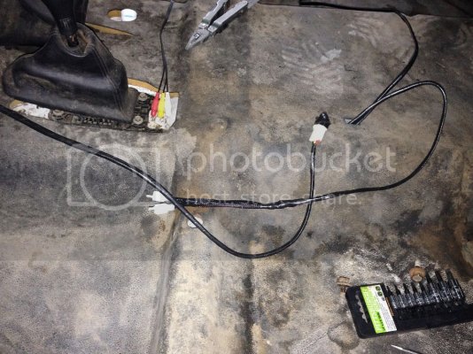

Wiring..well, everybody has a different idea, but this is how I did it. I was already going to run some other wires, so I removed the seat belt anchor and side floor mat trim. I cut a single hole in the mat above the transmission hump as I knew it's be an OK location. The two seat harnesses will be under the console and I knew I'd possibly need to conserve wiring as I didn't know if the harness would be adequate length. I ran that harness section along the shoulder of the transmission hump as the floor has a lot of irregularities due to seat mounts. This allowed me to have access to the center dash, where I mounted the switch and picked up some power.

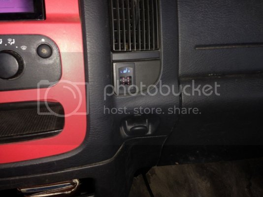

This particular kit uses a constant hot, switched hot, ground and illumination. I installed the switch in the panel where a passenger air bag switch would be. I picked up the switched hot and light wire for the ISO/Chrysler radio harness adapter I required for the Android HU. So, no cutting or splicing into factory wiring. The ground went to the metal dash frame and I ran a constant hot to the battery. There is a fuse and relay on section two of the harness. It fits in the dash recess behind the HVAC controls. From there, it goes to the switch.

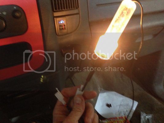

Now, to test the switch and harness before re-installing.
Everything seems fine. I re-installed the seats and console. This is a picture of the switch with everything back together and illuminated.
