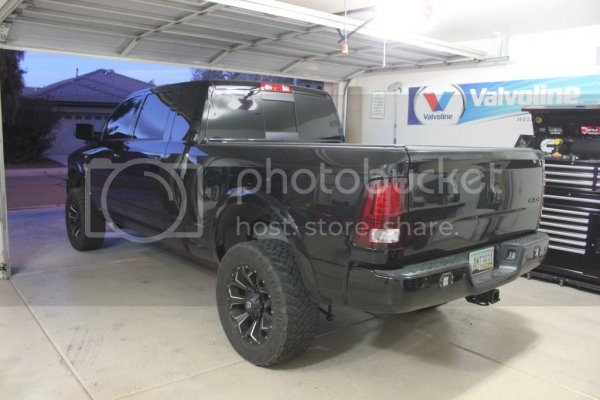

I will be putting a Thuren level kit with 2.75 in front and the 1'' coils in the back with front fox shocks and rear bilsten shocks, I had a good price for a Carli track bar so I will use that. Now without the lift kit s-19105549_10158736639265543_3793312450371880202_n.jpg

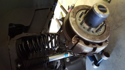

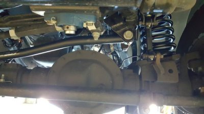

Installed my Thuren Springs 2", Track Bar and End links Saturday. Ordered Bilsteins Don recommended. Install went good. First Pic is before Install.

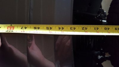

More---- After install. Measurements Before and after. Now for the Front End alignment and have the Steering wheel re centered. Rides nice!
Measures 43 1/4 in the Rear. 40 1/2 is before and 43" is after.

Looks sweet how was the install? My thuren coils and trac bar are sitting in the basement. Might attempt the install Tuesday. I have never done it before. Also what front hubs are u running?

Looks great man. I'm very interested to hear how you like the Dynatrac hub conversion? Benefits of the conversion? MPG?
I also see you installed the Thuren sway bar links.
Also what steering box brace do you have?

I decided to install the Dynatrac because It is free spin and serviceable bearings. Haven't noticed a big increase in MPG maybe 1 or so. Wanted to have a stronger end link with the setup and also are serviceable and grease zerk's. Purchased the Rough Country bar. Good quality and price. Most likely am going to install their rear links soon.

I used two floor jacks for either side of the axle. Two sets of jack stands one for the frame rails and a set for the front frame drop stubs. plenty of good info here to help. pretty straight forward just lowering the axle to get the springs out. Track Bar removes easily. Need to check and make sure you have the proper wrench sizes and torque wrench. The steering stabilizer is a nice improvement as far as dampening impacts and steering wheel jerking .
