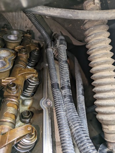

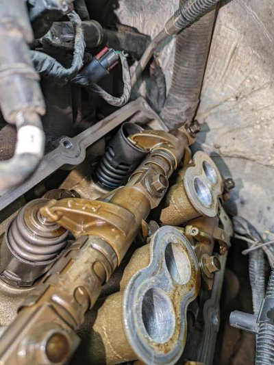

BAD NEWS:
The springs I put in are the new 'shouded' design. The shrouds are riding up the coils and at least one (#7 intake) is touching the rocker. A couple others are 'partially riding up' but not interfering yet.
Stand by for pix of driver side rocker train.
Bad, but maybe not as bad as removing the heads. ANYONE KNOW if there are special install techniques for the shrouded springs? I didn't do anything special, just put them in. Is there something on the bottom to 'index' the shroud into a fixed position? Googling now :(

BOULDER
2003
Enginetech valve springs fail. Shrouds 'ride up' on springs, cut into rockers doing damage. Have to tear down and replace with reputable parts. don't do it. Their support contact only says 'we can't help.'

BOULDER
2003
EngineTech failure
