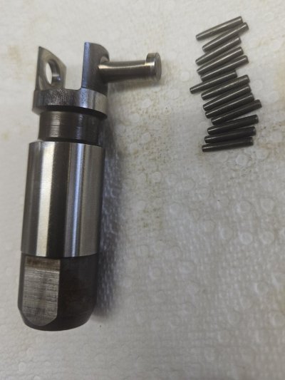

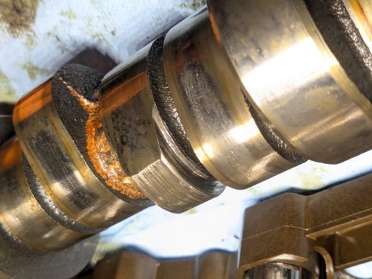

2014 Ram 1500 5.7 (149,000) miles on it. Had the check engine light come on 6 months ago. Also noticed engine shaking when going up hill. Once I dug into diagnosing everything. I determined I had the lifter tick issue. I drove the truck on very light small trips since , maybe 100-200 miles or so (as it could handle light acceleration. for a while . Seems to idle pretty normal and operate normally, except for (hearing the tick) and or harder acceleration.) until I was able to line up a time for me to attempt the repair myself. I intend on replacing camshaft, lifters, and go to a HV oil pump. (will probably also replace mds lifers with new ones as well, while I'm in there)

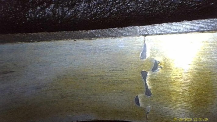

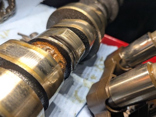

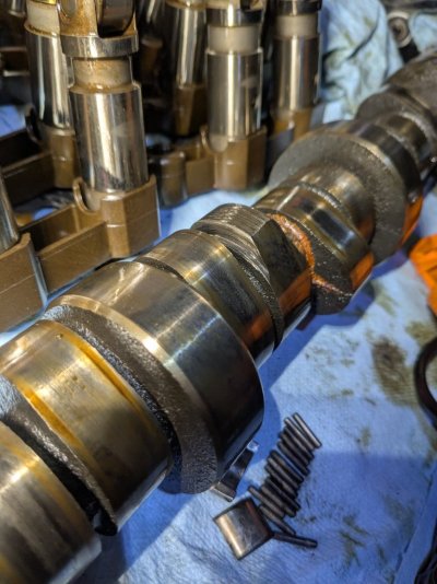

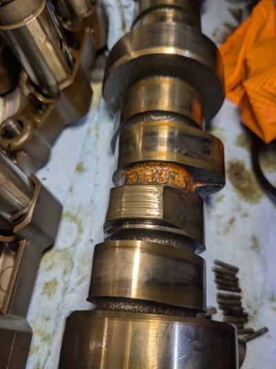

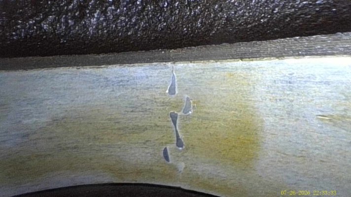

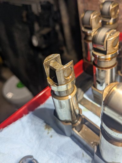

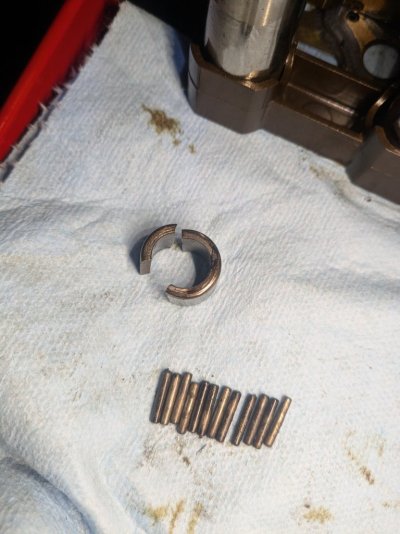

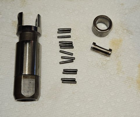

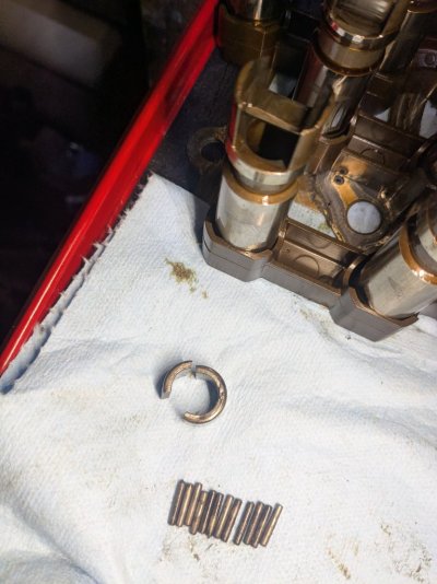

My question is I took out the #3 cylinder lifters and yes it was destroyed. (see pics). I did find the 75% of the pieces in the oil pan ( in pics). along with your stereotypical amount of glitter at the bottom of the oil pan.
it got me thinking though. Where is the rest of it? Did the rest of the roller bearings get crushed or worn. Did the missing pieces of the actual roller, get worn into the glitter?
Or is there some metal pieces sitting in some crevice of the engine waiting to dislodge from its resting place and try to cause internal damage?
I know nobody can say for sure that it will be fine or not if I replace the cam, lifters, oil pump and try to get as many miles as I can out of it. But I was curious of opinions.
Should I assume this is not a good engine to replace parts because of the "metal shavings " or "pieces of metal" possibly stuck somewhere in the engine?
Or are chances in my favor, and other pieces probably won't cause problems?
I appreciate any opinions, Thank You
