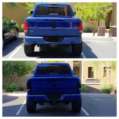

Just showing off a little project.
1 can VHT Niteshades.
1 can of clear enamel.
2000 grit sandpaper
Painters tape
Utility knife etc
End goal was to match the smoked 3rd brake light.
5 coats of tint and 4 coats of clear later.

Correct I painted them to match the rest of the vehicle. All good questions though.
Here is one more pic at 8pm in AZ where the sun is going down. As you can see the LED's are easily viewable.
I was concerned initially and ready to order a new pair just in case but I'm happy with the results.
I just need to sand the clear, use some rubbing compound and buff
