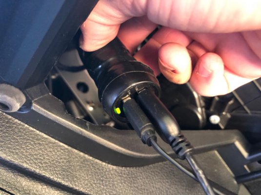

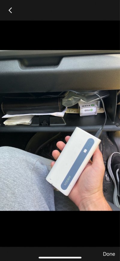

Just for what it’s worth, I wired another 12v socket behind the dash, tapped into the constant 12v that’s on the dash
I have a dual USB charger plugged into it, and routed the cables to hide them. I went ahead and plugged the dash cam in via the hidden USB, this seems like it was the lowest impact “hard wire”. bonus cause I gained a spare USB behind the dash, routed it to the glove box, and have a 20,000mah powerbank on trickle charge all the time
