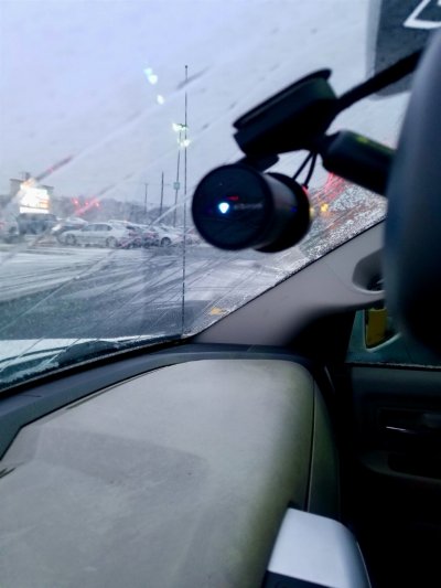

Not sure if you can see my old set up but here’s some photos.07b183fdd4a6581325c025a78a9cdce0.jpg

Weird? Mine was pretty straight forward... Soon as I connected the rear camera.. it showed up like pip on the front.

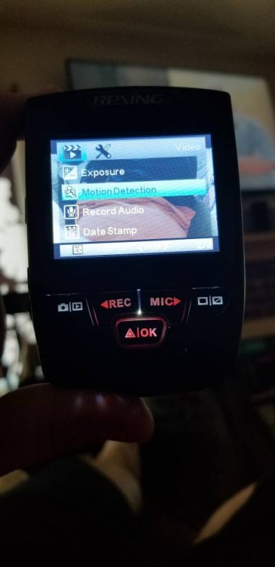

Mine doesn't have motion record so I might need to rewire it to something that is always on... Someone tried robbing my truck of it's tailgate...

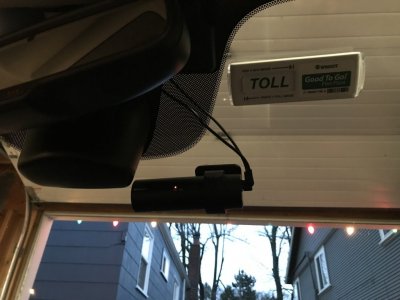

I have the same dash cam and the same wiring kit, hard wired it into my rear view mirror with the rexing wire kit.

Wonder if there's a firmware that'll let it record on motion... Seems silly that it doesn't

FWIW... I flashed the v1n expert fw to my v1p and.... Magically I have motion and parking detection now... f52f0ae426e25582580e9fd2dd0af1d8.jpg

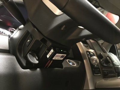

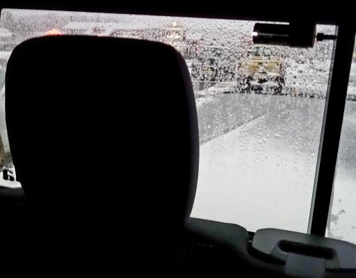

Started the install of the Blackvue 750 2 channel camera system. Comes with a front and rear camera. Installed the rear on on the passenger side (I have the power sliding rear window) and ran the cable along the headliner and rubber door sills - super easy to tuck it all out of sight. Power cable runs along the head liner and down the drivers side A piller down to the floor. I have fuse taps and firewall boot coming tonight (love same day delivery from Amazon!). Will drill the clutch plate and make the connection. Blackvue Powermagic allows the camera to record in park mode while protecting the battery. It has a timer and low voltage cut off.
So far so good - will post install pictures once completed.

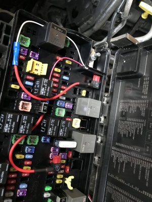

Finished the install tonight. Went with the BlackVue 750 2 channel camera with “Powermagic”, which allows recording while parked and shuts everything down if the voltage drops too low.
I used the firewall boot through the clutch plate cover and used fuse taps to make the connections.
Below are a few pictures, and yes the orange thing is an earplug to make a tight seal out of the boot.
