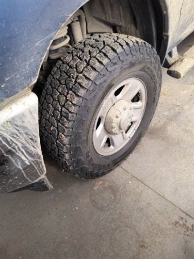

Wanted to give an update on the tire search. I ended up going with the Cooper Stronghold AT after talking to many people about a good all around tire for snow, mud, rain and ice. Good American Company and good warranty. Have had them for a few weeks now. I have zero complaints. I went with the 295/70 which are a little larger than the stock 275/70. Cheers

Is that going to affect the speedometer?

Yep it sure does. 50-70 MPH is 1-2 mph faster. 80 mph is 3 mph faster. I don't really drive over 80 to often so I am not concerned. The law (yes there is a law) allows for a 3% margin of error (either way). With that being said I am good to go.
