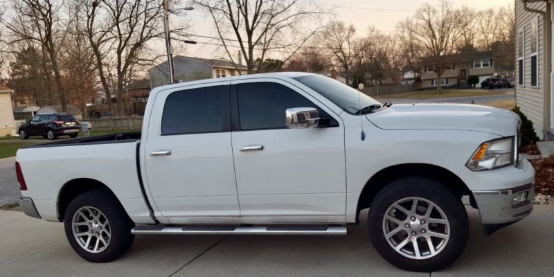

Here's where I am to be a pain lol. I currently have 20x9 wheels with oem fitment of 275/60 on them. I'm on Bilstein at 2.1. I want to go with a 295/60 tire to give a slighter fuller look. I don't want off road/ mud tires as I don't do any of that. My current tires are Michelin LTX which SUK in the snow even with 4x4. Does anyone have 295 or even a narrow 35" tire on this set up that they are willing to post photos and thoughts on please ?dfcfd34d8e167ce104faef2d63d31a1c.jpg
I can't guarantee it but you should be good with that size. There is a slight chance that you would need a 1/4" spacer

Now see I don't want any spacers so I may just grab a set of LT 275/60 with an A/T pattern if need be.
To be sure 10 mm / 1/4" spacer imo

^^^^. Thank you all for all of your help, I'm just going to stick with a stock size at 275/60. :)
