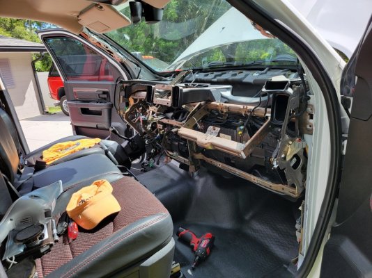

Nice job glad I found this have a wrecked sport and bought a 16 express about to pull all the interior out of sport and put in the express dash part had me worried until I found this
I've been looking to install a 1500 dash from a 2016 Sport into my 2013 Tradesman 3500. I pulled the upper glove box door from it. I can't think of any reason it wouldn't be compatible.
Ramagain
Nov 18, 2020
157
133
Florida
6.7
Completed finally. With the exception of the single screw under the glass it would have come off without having to remove/loosen the dash frame.

How many hours did it take?
Ramagain
Nov 18, 2020
157
133
Florida
6.7
This took me less than 2 hours. There may have been a beer break, lunch break, and time on the loo that added to total time. Lol
When I replaced the HVAC plenum, evap, and heater core it took 4 hours with coolant fluid burping so I kinda knew my way around already.

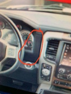

DeCo17
May 25, 2023
10
Florida
Hey, I know this is an old thread, but I am currently replacing mine and needing help locating the 2 trim pieces that frame the gauge cluster. Does anyone here know the part numbers to these or a link to where I can buy them? They do NOT come with the dash.
Thanks!
