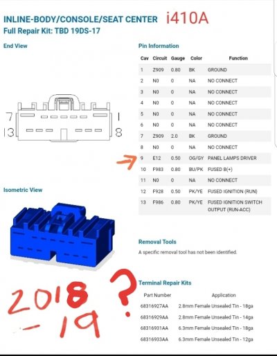

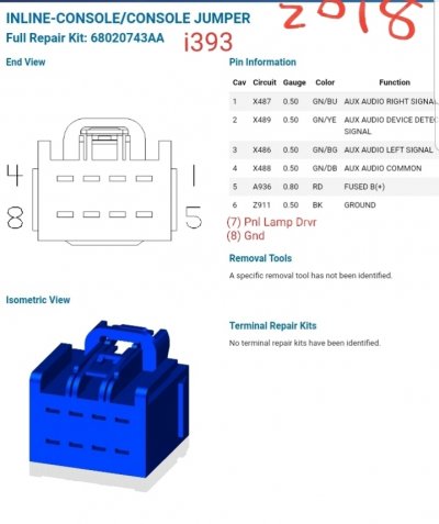

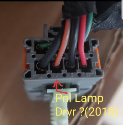

Pin 7 at the base/hinge of the lid's 8 pin connector.
My suggestion would be to cut it on the truck side and splice in a new wire to run to the back of the trailer brake switch connector (pin ?) to get the Panel Lamps Driver signal.

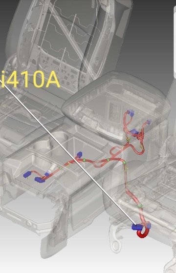

On the 18 (19 classic) trucks, the Pnl Lamp Driver signal is at the i410A pin 9 under the seat but despite tech authority/DCCtools connector info, I don't think that exists on the 13-17 trucks (trailer switch always had the signal & is the next closest spot).

I had looked this up for someone else that got my original 18 console lid. The 18/19 schematics still didn't show the Panel Lamps driver wiring at pins 7 & 8 last time I checked. I added the info once I had the lid out and traced the wiring in it.

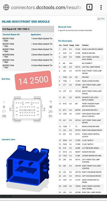

There are potential differences between trim levels and cab configurations with the wiring and signals even at the same connector... What may be a Can bus communication signal wire on your truck could be 12v direct from the battery ... Are you willing to get a Techauthority account and dig through and compare differences between the 2 trucks by VIN? I'm sure it could be done though.
Not to scare you but it's possible to have problems and best to keep your original wiring and just swap the cosmetic stuff over and do 8.4 conversion if needed.

I have some schematics linked in my signature you can reference that may help.
You're likely better off (safer) cannibalizing wires/terminals out of harnesses for specific functions and adding it to your trucks connectors as you go (but remove/grab the entire harness sections if possible to limit going back and forth) .... There's just not a single straight yes/no answer on it being plug n play with whole harness sections...
Example: 34pin front end module connector (under fuse box) on a
14 ram 1500 pins 2 & 3
vs 14 ram 2500 pins 23 & 24

I got the all black Rebel with white stitching installed today. Part Came out of a 2018 Rebel, went into my 2015 SLT (with all Laramie interior items). Looks pretty good, ill get some photos tom for those that are interested.
So far the orange/grey stripe wire theory is correct on my truck as well. The back light stayed on for awhile so I just pulled the wire out of the connector and taped it off for now. Until we figure out how/which wire to splice it into. I don't really want just cut the wire.

You'll need to run it up to and splice into the trailer brake switch connector. See post 40
