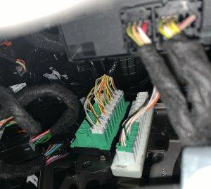

RD Depends on the cable. Mine, there are two pigtails that go into the Canbus and then a connector to the OBD port and another OBD connector to put the MX+ on. By diconnecting the one that goes to the factory OBD port I have effectively removed any impediment to the dealer using the OBD port. That was why I picked the Kaodtech cable versus the other versions that pug into the actual security module behind the radio.
Left is block 1, right is block 2
Plug the leads of the security module bypass into the CAN blocks.
RAM 1500
Lead with Green Connector
Plug into Block [2]
Lead with White Connector
Plug into Block [1] RAM 2500+
Lead Labeled White/Green
Plug into White/Green Block [2]
Lead Labeled Black/Green
Plug into Black/Green Block [1]
Note: If you are having difficulties accessing the CAN connectors, it is possible to remove the headlamp switch to gain better access to the connectors
5. Locate the OBD-II Connector [3].
Temporary Install
Plug the female end of the bypass harness into the factory OBD-II Connector. The bypass in now ready to use.
Permanent Install
Remove the factory OBD-II Connector by squeezing the two tabs on the backside of the connector and pulling it out of the mount.
Insert the Male plug of the bypass harness into the factory mount.

This is the link to his site. He is a member on here. The install instructions are PDFs you can access on the site. Just to be sure I am right, I have emailed him about what removing the bypass for Dealer Service exactly means. I can't see needing to remove the two pigtails that go into the Can Blocks, as long as the harness isn't plugged into the OBD port, but I have been wrong before.

I have the Kaodtech, too. In fact, I keep the two single cables plugged into the blocks, but keep the actual OBD plug disconnected and tucked behind the cabling. So it's "inactive" all the time, and when I do need to change something with AlfaOBD I just plug it into the ODB port and the Bluetooth device into the other end.
