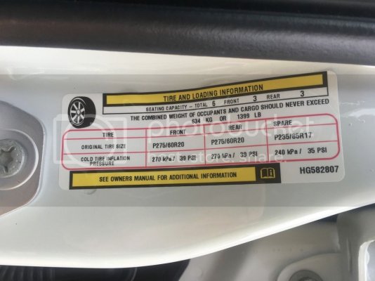

What does your door sticker say for payload? Yeah, you'd have to put a lot in that trailer to get it up over 6000#. I add roughly 1500-2000 to a 35' 5th wheel - the range is depending on how much water.

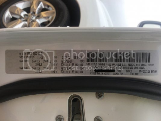

So, with payload max of 1399# you'll be over your truck's GVWR with what you propose. Axle rating of 3900 each is the most important to not overload which is why I mention E rated tires are overkill. My E rated tires are good 3600# a piece. Having 7200# tire ability for an axle that maxes out at 3900# doesn't make sense.
Best bet is to load your truck up like you're going camping (with the trailer if possible) and roll through a scale so you know what you're ultimately dealing with. If not with the trailer or people you can probably estimate pretty close.
