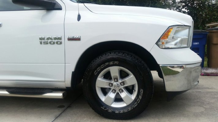

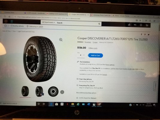

I had Cooper Discoverer A/T's that I got from WalMart. They were LT265/70R17 and were "E" rated 80 psi max.
I ran them 45 to 50 psi and never got a warning, but I never had cause to air them up more. They were awesome tires, I got 81k miles out of them. Plus, at that time, I got a set of 4 for ~ $675.
