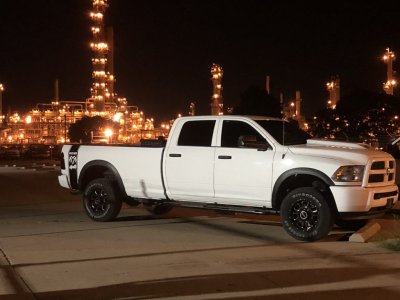

guys I know there are so many tire questions but I have read and read and apologise if I have missed it
My set up is completely stock suspension and no plans of lifting or leveling the truck
I love the nose down look of the ram truck and don't want to change it
I have put on my truck some vision wheels
18x8.5 with 0 offset
They stick out just a little bit with the factory tires on but when I replace them I want to go with a wider/taller tire so they don't look so small on my truck
My question is can I fit like a
35/12.5 18 with this offset
I hear on stock suspension you can fit a 35 with spacers but since mine are already moved out quite a bit with the aftermarket wheels would it fit?
Or would I be better with like
305-70r18
I do not want to lift/level
Trim or modify anything
Just want to fill the wheel well up a bit more then factory tire does
With the biggest tire I can
Thanks guys
Here is my current set up
2017 ram 2500 6.4 hemi
Crew cab long bed 4x4

If you want to fill the wheel well without going too wide and more likely to fit without a spacer. I would look at 285/75r18. I ran the Toyo AtII Xtreme and they ran at 34.8 while most 35x12.5 runs 34.6 tall.
I don't mind some more width Since I have the flares and would consider different flares if needed
I just don't want to have to do any modifying lol
Thank you for your reply I was looking at that size tire as well I seen a couple that looked pretty good

Thank you
I was looking through a bunch of those last night in my free time
It's hard to find one with no lift
Or with 0 offset etc
I thought maybe someone on this forum might have the setup I am looking at
It seems leveling these and running 35's is very popular but most popular is a big negative offset on a wide rim or a +18 or +22
I had +18 on my 15 Cummins truck and wanted them out further so went with the 0 on this truck
But I really like the way this truck sits so I don't really want to lift/level it
But as my factory tires wear out just exploring my options with a more aggressive look for the truck
Without trimming cutting or lifting
I really like the look of the 35x12.5
Just not sure they would clear or if I should even put a 12.5 on a 8.5 wide wheel
