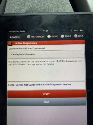

Ok I just updated my tire size and all went well except when trying to “Clear Rolling Info” Alpha said the task failed. Something about not being able to complete the task in diagnostic mode. I thought I had a pic of it but didn’t get it unfortunately. I took the truck for a spin and everything is working fine so far. I’m off by about 1-2 mph. Anyone have any thoughts on this? Is this normal?
If you don't have any check engine or abs codes showing then the failed task may just be a bug similar to changing mileage when it says it failed but actually worked. If it did indeed change your tire size then I'd say you are fine to try again

I just installed 20” Laramie wheels and tires on my 1500 and had the same issue. I followed instructions and on the last step got the same failure message when trying to clear rolls info. I tried twice without success until I changed the last step in the process. After Static ECU Initialization I didn’t cycle the key but left it in the run position and then went through with the Clearing Rolls information step. Procedure completed! The final step included clearing the error codes in the body and abs functions.
I road tested and compared speeds with a gps unit in MPH mode and the speeds matched with the cluster speed.
This worked of me and your results my be different. Consider the possibility of another issue arising by not following the proven steps of others.
