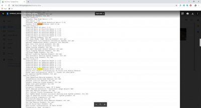

Wondering if yall might be able to help me out, maybe point out where I went wrong since I haven't been successful with updating my tire size via AlfaOBD.
2019 Ram 1500 Classic Tradesman Express
AlfaOBD version 2.1.7.0
Nexus 7 Android version 6.0.1
OBDLink MX Bluetooth
Turn key to run
Plug OBDLink into OBD port
Open AlfaOBD app
Connect to OBDLink via BT
Select Dodge/Ram
Select Ram 1500 DS/DX
Select body computer
Select body computer MY2016-17 powernet
(Have also tried w/ MY2013-17 powernet)
Select connect
Select vehicle w/ hood up icon
Select program tire size from drop down
Manually enter 2720mm (nitto 275/65r20 Terra g2)
Select start
Wait until confirmation of entered circumference
Back out to main AlfaOBD screen
Turn key to off
Wait ~1min
Turn key to run
(No dash warning lights except for check engine light)
Select ABS from drop down menu
Select ABS Ate/Continental from drop down menu
Select connect
(Once connected - abs dash light, brake dash light, service electronic braking system message)
Select car w/ hood up icon
Select ABS initialization
Read instructions
Select static ECU initialization from drop down
Select start, wait for complete
Select check engine icon
(no faults reported)
Select clear faults anyways
Turn key to off
Turn key to run
Select clearing rolls information
Select start
Failed. Service not supported in Active Diagnostic Session.
I've checked the BCM/Engine for fault codes, none present.
I've forced closed the app. Let the truck sleep for a bit, reconnect everything and try again. Still error out in the same spot.
I've tried waiting a few days inbetween attempts and still no luck.
Attached is a screen shot of my vehicle config., highlighting the dynamic tire circumference. The only odd thing about this is the second entry for dynamic tire circumference does not match the first and is quite a bit larger. Unsure if this is indicative of something that is incorrect.
Thanks.
Edit: I checked in shared google drive for shared BCM config. files and the ones posted match the 2640 and 65535 entries for dynamic tire circumference.

While going through AlfaOBD, changing some other settings, I came across "VehConfig 4-Dynamic Tire Circumference (All or Rear) in the BCM>Body Computer>Car Configuration Change. All it has is a box to manually enter a circumference. A hint is given stating that if the ABS throws faults after changing the tire size, run ABS initialization procedure available in the ABS diagnostics.
Based on the successful posts throughout this thread, modifying this parameter isn't required to change tires sizes, but I wonder if updating it here would change the value stated in the config file?
1500ram12
Jan 23, 2012
5,487
2,432
2005
5.9L Cummins
I tried it when I updated my tire size recently and it still didn't change anything in the config files. It's possible that it's just something that can't be charged or something alphaobd can't change yet. It was recently added but he may not have the code correct to make the changes in the bcm to show the new tire size.
2018 2500 6.4L
