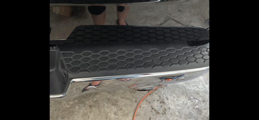

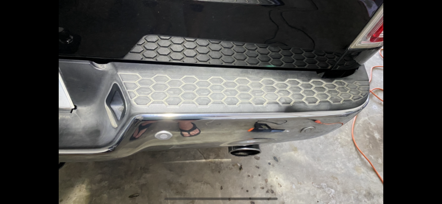

I did the heat gun treatment on my bumper and running board steps. Turned out really good !!!
BigTex13
EMT
Sep 27, 2020
35
21
Texas
HEMI 5.7
Keep in mind if you use the heat gun method it is just a band aid fix and will cause more problems in the future by drying out the plastics. Solution finish (https://www.autogeek.net/solution-finish-restorer.html) works great and is what a lot of professional detailers use to restore plastic trim.
SEM bumper coater (https://www.semproducts.com/product/bumper-coatertm-aerosols#product-details) works great to repaint bumpers. The SEM prep soap to clean and prep the surface prior to painting. No primer or adhesion promoter needed.
Yeah, did that too, and was great for maybe 1-1.5 years, forget how long its been, but its back to faded. That's my issue, nothing really lasts, lol! Going to try the Plastidip after festivities Monday and see how it goes, since I already have cans left over and if it sucks I can peel it off and try these other suggestions.
